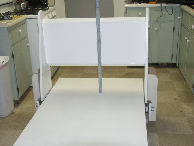

How does that saying go, measure twice cut once? Well I think I should have measured 4 or 5 times. I accidently made the gantry too narrow at the rails. I went ahead and widened the gantry since it would be easier to do than modifying the bed. Everything worked out ok and now the gantry is more rigid than ever. here are some pictures.
I still have to make a base for my machine and finish painting it.
I'll try to send a link to a video I made of the gantry moving back and for the on the rails.

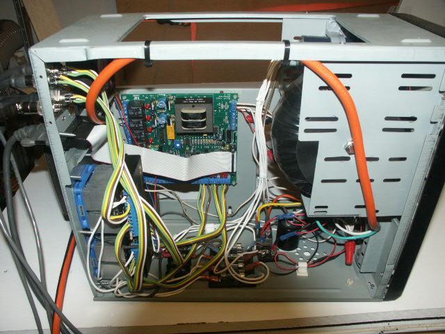

Right now I'm waiting for my Acme screw, they are not due in for another 10 days or so. Today I've been working on the electronic, I put them in an old computer case I had laying around. I'm going to finish up the Z axis (minus the drive screw) tommorrow.

Great news guys! My electronics are done and I didn't blow up the machine!
All my motors are jogging, I finished the Y-Axis and moving on to the Z-Axis. I still need to do some fine tuning to the motors. I'll upload pictures in a couple of days.

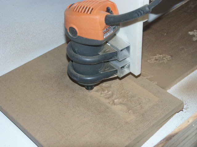

My machine is up and running! here are some pictures:
another,
Still needs some paint.

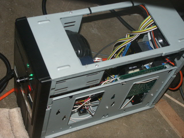

I'm still working on the finish details such as motor tuning, axis tuning and dust collection. I'll post pictures of the electronics in a day or two.

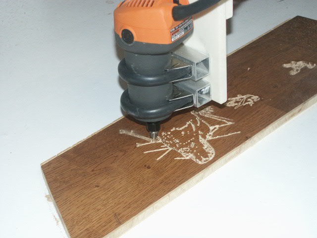

Now I just have to learn how to use it. I've started to design parts already but it is a bit difficult. I need to get some more g-code samples to try out on my machine I haven't had too much luck locating anything on the net. I also need to buy some small endmills to use on the machine. I'll continue to keep you all updated on my progress.

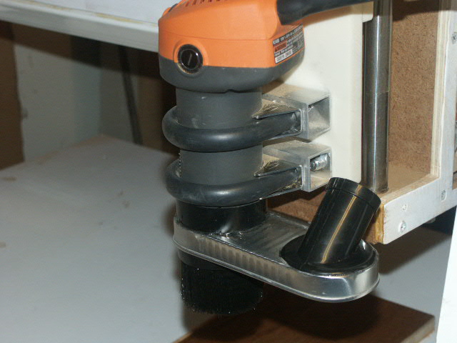

How do you like my new sardine can vacuum port?

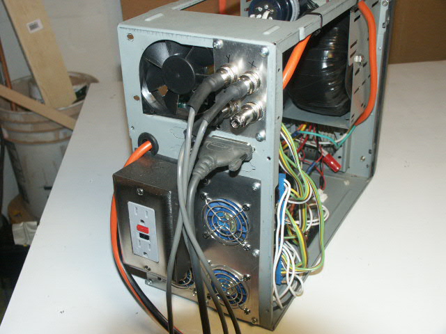

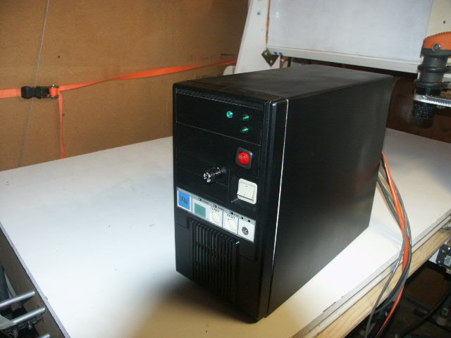

Here are some pictures of the heart of the system:

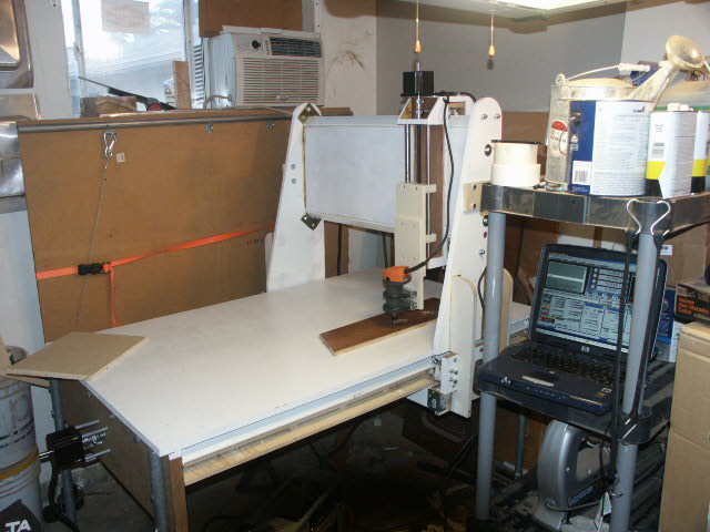

Here is a glamour shot, although it's not as sexy as John and Nelsons machines, I still like the way it came out.
